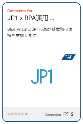

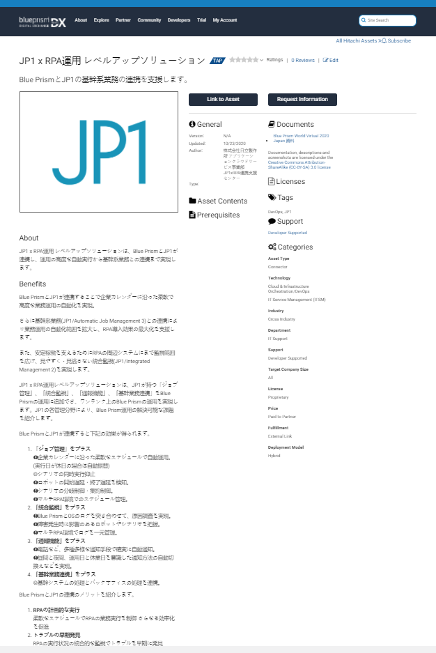

When a non-English speaker uses the DX, the non-English assets on the explore page are displayed with English headers, footers, buttons, and column text. For example, below is a Japanese language Asset page and Asset card. Notice the English text that comes from the Single Page App (SPA).
Figure - A Japanese Asset Page with English Column Text, Headers, and Footers.
Figure - A Japanese Asset Card with English Column Text, Headers, and Footers.
When this problem is examined closely, we see that there are two issues at play:
